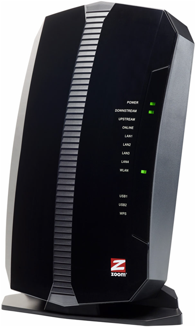

Front View
image of the Front View of the Zoom 5354
Click to enlarge.
  • The Zoom / Motorola 5354 is a DOCSIS 3.0 device offering 8x4 channel bonding.
  • After the cable modem is successfully registered on the network, the Power, Downstream, Upstream, and Online indicators illuminate continuously to indicate that the cable modem is online and fully operational.

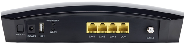

Back View
image of the Back View of Zoom 5354 modem
Click to enlarge.
The Zoom 5354 has the following ports and buttons available on the back of the modem.
  • ON / OFF - Turns the modem on and off.
  • POWER - Connects to the power adapter.
  • USB1 - Located on top of device; connects to a USB Flash drive or hard drive.
  • USB2 - Connects to a USB Flash drive or hard drive.
  • WLAN - Press and hold this button for five seconds to turn WiFi connectivity on and off.
  • WPS / RESET - Press and hold this recessed button at least 10 seconds to restore to factory defaults and reboot the modem.
  • LAN 1 2 3 4 - Connects devices to the 10/100/1000 Ethernet port. Only one port is active at a time.
  • CABLE - Connects to a coaxial cable.

The modem lights indicate the current status of your cable modem / router. To troubleshoot any connection problems, use the table below.
Modem Light Status Problem
Power LED On None. The modem is powered on.
Off No power. Verify power supply connections and electrical outlet. Ensure the outlet is not connected to a switch. Press the ON/OFF button on the back of the modem to ensure it is turned on.
Downstream LED Solid Blue None. Multiple downstream channels are in use.
Blinking Blue None. Negotiating multiple downstream bonded channels. Verify all cable connections and try resetting the modem. If cable is OK and modem reset does not work, contact Customer Support.
Solid Green None. One downstream channel is in use.
Blinking Green None. Scanning for downstream channels. Verify all cable connections and try resetting the modem. If cable is OK and modem reset does not work, contact Customer Support.
Upstream LED Solid Blue None. Multiple upstream channel is in use.
Blinking Blue None. Negotiating multiple upstream bonded channels. Verify all cable connections and try resetting the modem. If cable is OK and modem reset does not work, contact Customer Support.
Solid Green None. One upstream channel is in use.
Blinking Green None. Scanning for an upstream channel. Verify all cable connections and try resetting the modem. If cable is OK and modem reset does not work, contact Customer Support.
Off No upstream channels are in use. Verify all cable connections and try resetting the modem. If cable is OK and modem reset does not work, contact Customer Support.
Online LED On None - the modem is online
Blinking None - the modem is registering a connection
Off The modem is offline. Verify all cable connections and try resetting the modem. If cable is OK and modem reset does not work, contact us.
LAN 1 2 3 4 LEDs Green None. A device is connected to the Ethernet port and is using 1 Gbps LAN speed.
Amber None. A device is connected to the Ethernet port and is using 10 or 100 Mbps LAN speed.
Blinking None. Data is being transferred over the Ethernet connection.
Off No device is connected or the device is disabled. Verify all cable connections and try resetting the modem. If cable is OK and modem reset does not work, contact us.
USB 1 2 LEDs Off No device is connected.
Solid Green None. USB network attached storage device or media server is connected.
Blinking Green None. Reading or writing to a USB device.
WLAN LED Off WiFi is not enabled. Press the WLAN button on the back of the modem to ensure WiFi connectivity is enabled.
Blinking None. Data is being transferred over the WiFi connection.
On None. WiFi is enabled.
WPS LED Blinking None. WPS is in discovery mode.
On None. WPS configuration is successful.
