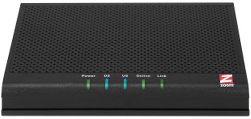

Modem Light | Status | Problem |
Power | Off | No power - Verify all cable connections and try resetting the modem. |
On | None |
DS (Downstream) | Blinking Green | Establishing a connection from the Internet to the computer - Verify all cable connections and try resetting the modem. |
Solid Green | None - connection |
Blinking Blue | Negotiating a bonded DS (downstream) channel - Verify all cable connections and try resetting the modem. |
Solid Blue | One or more DS (downstream) channels are bonded |
US (Upstream) | Off | Establishing a connection from the computer to the Internet - Verify all cable connections and try resetting the modem. |
Solid | None |
Blinking Blue | Negotiating a bonded US (upstream) channel - Verify all cable connections and try resetting the modem. |
Online | Blinking Green | Establishing a connection to the cable provider - Verify all cable connections and try resetting the modem. |
Solid Green | None - connection established |
Off | Offline - Verify all cable connections and try resetting the modem. |
Link | Blinking Green | None - data flowing |
Solid Green | None - connected to LAN device, like computer or router |
Off | No Ethernet found |
