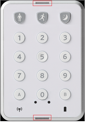

The following information supports the SMC Wireless Keypad.
The LED Status Indicator Light located at the top and bottom of the keypad indicates the current status of the system.
The table below describes the system condition for each of the colors transmitted.
Color of Light | System Condition |
Green | The system is disarmed. |
Red | The system is armed. |
Gold | The system is not ready to be armed. Example: A door or window is open. |
