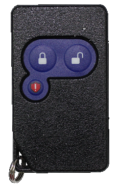

Extended Range Key Fob
Image of the Extended Range key fob
Disarming your security system with your key fob does not require a keypad code to be entered. Your key fob also provides an emergency alarm function anywhere within approximately a 100-foot range of the touchscreen.
Use the following table to learn how the different buttons function and what the corresponding lights indicate.
FunctionActionLightSystem Condition
Arm AwayPress the lock button for about two secondsFlashes red then stays solid redSystem is armed away
Arm StayPress the lock button for about one second, release, then press again for about two secondsFlashes amber then stays solid redSystem is armed stay
DisarmPress the unlock button for about two secondsFlashes green then stays solid greenSystem is disarmed
System StatusPress the unlock button and hold for about two seconds and release, then press again for about two secondsFlashes amber
Solid Green = disarmed
Solid Red = armed
Solid Amber = system not ready (a door or window is open)
Panic AlarmPress red exclamation point button for about three secondsFlashes redSystem sends a panic alarm
