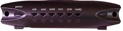

Front View
Front View
Click to enlarge.
After the cable modem has successfully registered on the network, the USB or Enet, Ready, and Sync indicators illuminate continuously to indicate that the modem is online and fully operational.

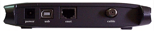

Back View
Back View
Click to enlarge.
The Ubee / Ambit SpeedStream 60678EU has the following ports available on the back of the modem.
  • Power - Connects the cable modem to the power adapter.
  • USB - Connects to the USB port on your computer.
  • Enet - Connects to the Ethernet port on your computer.
  • Cable - Connects to the cable wall outlet.

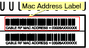

MAC Address
MAC label
Click to enlarge.
MAC addresses are written as 12 digits containing both letters and numbers (0-9, A-F).A MAC address is unique. The first six characters of the MAC address are unique to the manufacturer of the device.
Troubleshooting
The modem lights indicate the current status of your cable modem. To troubleshoot any connection problems, use the table below.
Modem LightStatusProblem
PowerSolid GreenNone.
OffNo power. Verify power supply connections and electrical outlet. Also make sure the outlet is not connected to a switch.
USBSolid GreenNone. USB connection to the computer found.
OffNo USB found. Verify USB cable connections, the TCP/IP settings and the USB cable. You might need to reinstall the USB drivers.
EnetSolid GreenNone. Ethernet connection to computer found.
OffNo Ethernet found. Verify Ethernet cable connections, the TCP/IP settings and the NIC. You might need to reinstall the NIC drivers.
SendFlashing GreenNone. Transferring data.
RecvFlashing Green
Sync and Ready LED Off. Searching for cable connection.
Sync and Ready LED On. Transmitting data.
Verify all cable connections and try resetting the modem.
OffNo cable connection. Verify all cable connections and try resetting the modem.
SyncSolid GreenNone
ReadySolid GreenNone
