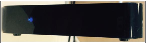

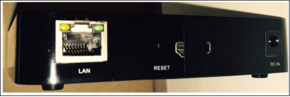

See the table below for solutions to common problems and suggested troubleshooting actions with your Cox Homelife Playback Adapter. To correctly identify your Cox Homelife Playback Adapter, a picture of the front and back has been provided.
If any of the suggested actions do not fix your issue, then contact Customer Support.
Front View
PBA Front View
Back View
PBA Back View

  • On the back of the adapter, confirm that the power cord is plugged in tightly.

  9. Wait up to 10 minutes or until you verify that you have a blue light on the front of the PBA and a yellow flashing data light on the back.
    Notes
  • Make sure the Playback Adapter (PBA) is plugged directly into the Security Router
  • After resetting ensure you have a blue light on the front of the PBA and a yellow flashing data light on the back.
