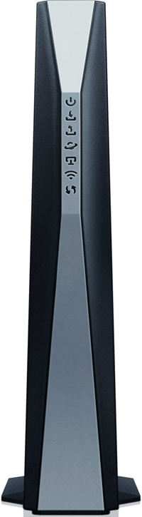

Front View
image of modem front view
Click to enlarge.
After the cable modem is successfully registered on the network, the Power, Downstream, Upstream, and Internet indicators illuminate continuously to indicate that the cable modem is online and fully operational.
