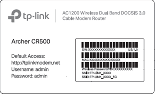

MAC Address / WiFi Network Label
MAC and WiFi label
Click to enlarge.
This label is located on the bottom of the device.
  • MAC addresses are written as 12 digits containing both letters and numbers (0-9, A-F).
    • A MAC address is unique.
    • The first six characters of the MAC address are unique to the device's manufacturer.
  • The default Network Name (SSID) and Wireless Password (PIN).
