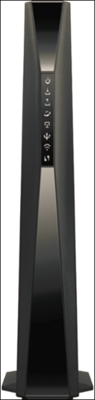

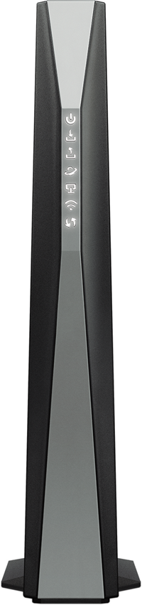

Front View
Front view
Click to enlarge.
After the cable modem is successfully registered on the network, the Power, Downstream, Upstream, and Internet indicators illuminate continuously to indicate that the cable modem is online and fully operational.

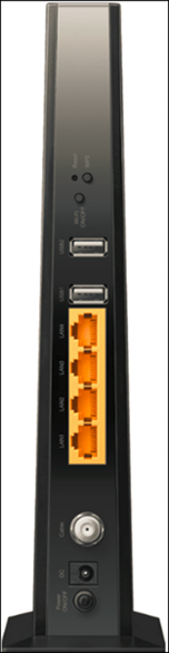

Back View
Back view of modem
Click to enlarge.
The following ports are available on the back of the modem.
  • RESET - Use a pin to press and hold for at least 8 seconds to restore factory settings
  • WPS - The button to enable or disable the WPS function
  • WiFi ON/OFF - The button to enable or disable the WiFi function
  • USB1 and 2 - Connects to a USB storage device or printer
  • LAN1-4 - Connects devices to the 10/100/1000 RJ45 Ethernet ports. Only one port is active at a time.
  • CABLE - Connects to coaxial cable
  • DC - Connects to the power adapter
  • Power ON/OFF - The button to turn on or off the power

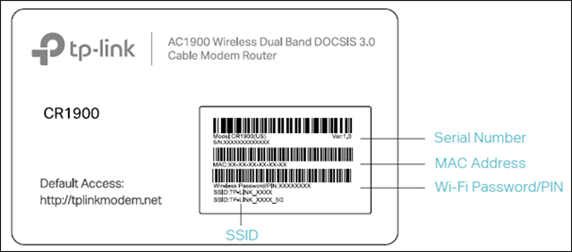

MAC Address / WiFi Network Label
MAC and WiFi label
Click to enlarge.
This label is located on the bottom of the device.
  • MAC addresses are written as 12 digits containing both letters and numbers (0-9, A-F).
    • A MAC address is unique.
    • The first six characters of the MAC address are unique to the manufacturer of the device.
  • The default Network Name (SSID) and Wireless Password (PIN).
