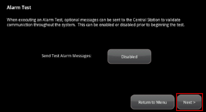

  2. Tap Alarm Test.

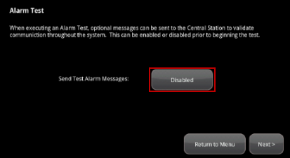

From the Alarm Test screen, to prevent your test alarms being sent to the CMS, press Disabled.
Note: Send Test Alarm Messages defaults to Disabled. By pressing the button you can toggle between Disabled and Enabled.
Image of the Alarm Test screen
Result: The Send Test Alarm Messages changes to Enabled. Your test alarms will be sent to the CMS.
Image of the Alarm test showing enabled
If you enable Send Test Alarm Messages, contact Cox Homelife at 877-404-2568, and notify us that you are testing your system.
Tap Next.
Image of the Alarm Test screen highlighting Next

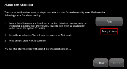

On the Alarm Test Checklist screen, complete the following steps.
  1. Confirm that all windows and doors are closed and that the motion detectors are not showing any motion.
    Note: When the security zones are ready for testing, Ready to Arm displays under the Arm button.
    Image of the Alarm Test Checklist highlihgting Ready to Arm

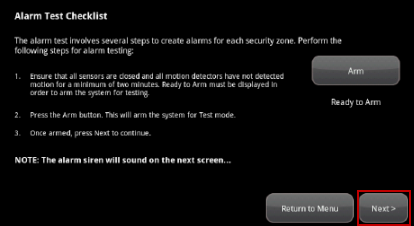

  2. Tap Arm.
    Image of the Alarm Test Checklist highlihgting Arm
    The Arm button changes to System Armed to indicate your security system is armed in the special Test mode. The Exit Delay is ten seconds instead of thirty seconds. Motion detectors are turned off until a door or window is opened.
  3. Tap Next.
    Image of the Alarm Test Checklist highlihgting Next

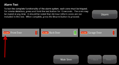

On the Alarm Test screen, you must complete the following tasks.
  1. Open and close an entry point.
    Results:
    • A 30 second Entry Delay period begins.
    • The Touchscreen beeps once per second.
    • The beeping increases to twice per second in the last ten seconds.
    • The motion detectors are turned on.
    • At the end of the Entry Delay period the siren sounds.
      Note: The siren can be muted prior to testing by tapping Mute Siren. Muting the siren is not recommended. Ensuring the siren is in working order is an important part of the test.
  2. Continue to open and close each entry point. Ensure that it is marked with a red ALARM indicator.
    Image of the Alarm Test screem showing a red Alarm
  3. Perform all of the applicable tests listed in the table below.
