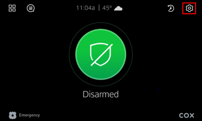

On the touchscreen home screen, tap Settings.
Image of the touchscreen home page highlighting the Settings option

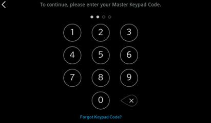

Enter the Master Code to proceed to the Settings menu.
Image of the touchscreenMaster Keypad Code screen

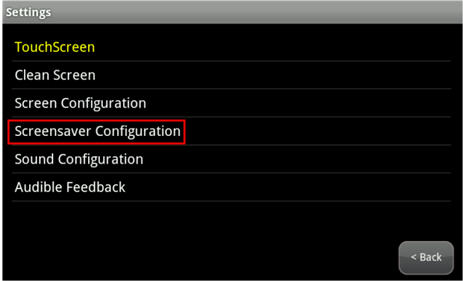

From the Settings menu, tap TouchScreen.
Image of the Settings menu highlighting the TouchScreen option
From the Touchscreen menu, tap Screensaver Configuration.
Image of the Touchscreen Settings menu highlighting the Screensaver Configuration option

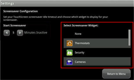

On the Screensaver Configuration screen complete the following steps:
  1. Tap the left Start Screensaver arrow to decrease the time elapsed before the screensaver activates. Tap the right Start Screensaver arrow to increase the time elapsed before the screensaver activates.
    Image of the Screensaver Configuratiuon screen highlighting the Start Screensaver option
    The maximum time elapsed is 30 minutes, the minimum is 5 minutes.
  2. Scroll to see the available screensavers. Tap the screensaver that you would like to use.
    Image of the Screensaver Configuratiuon screen highlighting the Select Screensaver Widget options
    Note: If the screensaver does not display, attempt to reboot the touchscreen.
