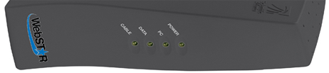

Front View
Front view of Scientific Atlanta Webstar Dpx-2100 Cable Modem
Click to enlarge.
After the cable modem successfully registers on the network, the POWER, PC, and CABLE indicators illuminate continuously to indicate that the cable modem is online and fully operational.

The modem lights indicate the current status of your cable modem. To troubleshoot any connection problems, use the table below.
Modem LightStatusProblem
PowerOffNo power. Verify power supply connections, the power switch on the modem itself, the electrical outlet, and make sure the outlet is not connected to a switch.
PCOff / BlinkingNo Ethernet / USB signal. Verify cable connections and try resetting the modem.
SolidNone. Ethernet / USB carrier present.
CableSolidNone. Registered on the network.
Slow FlashingSearching for cable connection. Verify all cable connections and try resetting the modem.
Fast Flashing ModemSearching for cable connection. If this is a new modem or a replacement modem, you must contact Cox with your MAC address. If there are several MAC addresses on the modem, use the HFC or RF MAC address.
OffNo cable connection. Verify all cable connections and try resetting the modem.
DataBlinkingNone. Software upgrade or cable activity.
