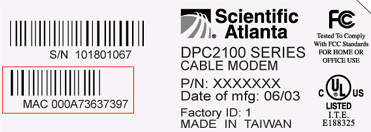

MAC Address
Image of the dpc2100 mac label
Click to enlarge.
