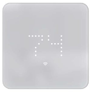

Zen Brand AA Alkaline Battery (4)
Image of Zen Thermostat Image of AA Alkaline Batteries
  1. Remove the faceplate of the thermostat by gripping the sides and pulling it away from the wall.
  2. Remove the old batteries and dispose of them properly, as recommended by the battery manufacturer.
  3. Insert four AA Alkaline batteries, observing proper polarity.
  4. Replace the faceplate onto the base.

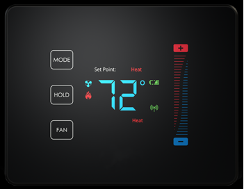

Centralite Brand AA Lithium Battery (4)
Image of Centralite Thermostat Image of AA Lithium Battery
Watch the video.
  1. Remove the front cover by pulling the outer edges of the thermostat towards you.
  3. Replace all old batteries with four new batteries.
  4. Replace the cover by gently snapping it back into place.

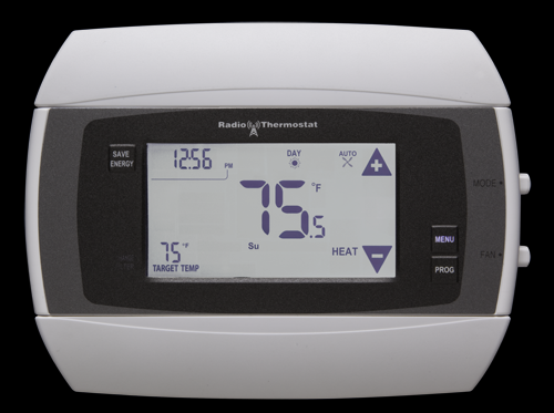

Radio Thermostats of America Brand AA Alkaline Battery (3)
Image of Radio Thermostat Image of AA Battery
Watch the video.
  1. Slip off the bottom white panel of the front cover by pulling it towards you from the right side.
  3. Replace all old batteries with three new batteries.
  4. Replace the cover by snapping it into place.
