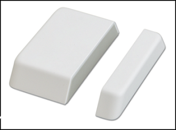

Visonic Brand MCT-320 CR2 Battery (1)
Image of Door and/or Window Sensor Image of CR2 Battery
  1. Insert a small flathead screwdriver into one of the small notches located on the same side as the magnet.
  2. Twist the screwdriver to pop off the sensor cover and set it aside.
  3. Remove the old battery and dispose of it properly, as recommended by the battery manufacturer.
  4. Replace with the new battery.
  5. Push the cover back on the sensor until it clicks into place.
