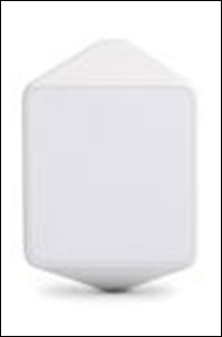

Visonic MP-841 Motion Sensor | Replacing the Batteries |
![Image of the Visonic MP-841 sensor](https://www.cox.com/content/dam/cox/residential/support/homelife/images/VisonicMP841MotionSensor_2020.png) | This device requires two CR123A batteries. - Press upward on the motion sensor to separate the motion sensor from the bracket. This procedure is used when the motion sensor is mounted on the wall.
- Replace the batteries using two Lithium CR123A batteries. Ensure the batteries are in the right polarity.
- Put back the motion sensor on the bracket using the same instructions after mounting the bracket.
- Push down until a click is heard.

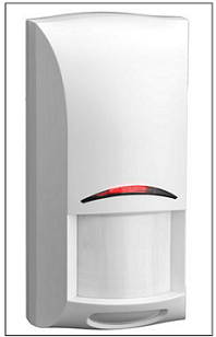

Bosch Brand - Model #ISW-ZDL1-WP11G | Replacing the Batteries |
![Image of the Bosch Brand sensor](https://www.cox.com/content/dam/cox/residential/support/homelife/images/bosch_motion.png) | This device requires six AA batteries. - To open the sensor, unlock it by inserting a small screwdriver into the locking notch located on the bottom of the sensor. Turn it to the unlock position.
- Hold the base and slide the unit body down to remove it from the base.
- Remove the old battery and dispose of it properly, as recommended by the battery manufacturer.
- Insert new batteries.
- To close the sensor, slide the detector back onto the base and lock the detector at this time.
