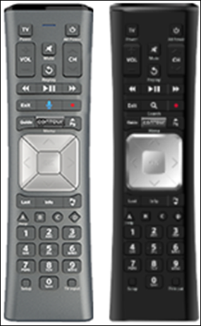

    New Contour Voice Remote
    image of xr15
    For the New Contour Voice Remote (XR15), press and hold the Contour and Info (i) buttons together on the remote until the red LED on the remote turns green.
    Contour Voice Remote / Contour Remote
    image of xr11 xr5
    For the Contour Voice Remote (XR11) or Contour Remote (XR5), press and hold the Setup button on the remote until the red LED on the remote turns green, then press the Contour (Menu) button.The LED on the remote flashes.
