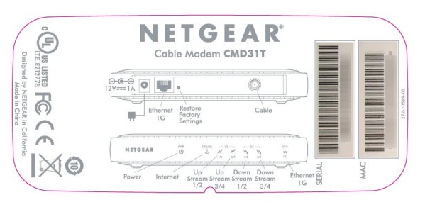

MAC Address
Image of CMD31T MAC address label
Click to enlarge.
The information below is usually found on a sticker located on the bottom of the modem.
  • The S/N is the serial number of the Netgear CM600 modem.
  • The CM MAC is the MAC address of the Netgear CM600 modem.
