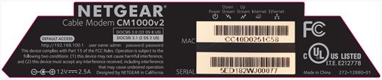

MAC Address
Image of MAC Label
Click to enlarge.
