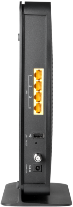

Back View
Back View of the modem and lights
Click to enlarge.
The Netgear CG4500BD has the following ports available on the back of the WiFi modem:
  • GE 1-4 (Gigabit Ethernet 1-4 also known as LAN 1-4) - Four 10/100/1000 auto-sensing RJ-45 ports. Connect devices on your LAN (Local Area Network) such as a computer, hub or switch to these ports. Only one port is active at a time.
  • USB - Connects to the USB port on your computer.
  • RESET - Use this button in the unlikely event that you want to restore the default factory settings. This button is recessed to prevent accidental resets of your WiFi modem. See Netgear's support article for steps on how to reset your device to factory settings.
  • CABLE - Connect your coaxial cable line to this port.
  • AC IN - Connect the supplied power cord to this port.
