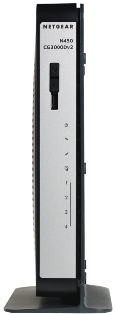

Front View
image of Front View of the modem and lights
Click to enlarge.
  • The retail version of this device is known as the N450.
  • The highest service level is based on wired connectivity speeds.
  • After the device is successfully registered on the network, the POWER, DS, US, and ONLINE indicators illuminate continuously to indicate that it is online and fully operational.

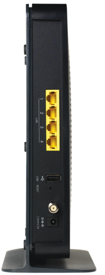

Back View
image of back view of the modem
Click to enlarge.
The Netgear CG3000Dv2 has the following ports available on the back of the WiFi modem.
  • GE 1-4 (Gigabit Ethernet 1-4 also known as LAN 1-4) - Four 10/100/1000 auto-sensing RJ-45 ports. Connect devices on your LAN (Local Area Network) such as a computer, hub or switch to these ports. Only one port is active at a time.
  • USB - Connects to the USB port on your computer.
  • RESET - Use this button in the unlikely event that you want to restore the default factory settings. This button is recessed to prevent accidental resets of your WiFi modem. See for steps on how to reset your device to factory settings.
  • CABLE - Connect your coaxial cable line to this port.
  • AC IN - Connect the supplied power cord to this port.

Troubleshooting
Modem Light Status Problem
Power
Image of the Power light
Off No power - Verify all cable connections and try resetting the modem.
Solid Green None
DS
(Downstream)
image of the Downstream light
Blinking Green Scanning for downstream channel - Verify all cable connections and try resetting the modem.
Solid Green None - connection from the computer to the Internet
Solid Blue None - operating on more than one channel (downstream bond mode)
US
(Upstream)
Image of the Upstream light
Off Upstream channel inactive - Verify all cable connections and try resetting the modem.
Blinking Green Scanning for upstream channel - Verify all cable connections and try resetting the modem.
Solid Green None - connection from the Internet to the computer established on one channel.
Solid Blue None - operating on more than one channel (upstream bond mode)
Internet
Internet light
Off No connection - Verify all cable connections and try resetting the modem.
Solid Green None - cable WiFi modem operational
Slow Blink None - cable WiFi modem receiving DHCP information
Fast Blink None - cable WiFi modem downloading a configuration file
LINK 1 - 4
Image of the Link light
Off No Ethernet link detected
Blinking Green None. Data is flowing.
Blinking Amber None - data flowing
Solid Green None - connected to 1000 Mbps
Solid Amber None - connected at 10 or 100 Mbps
WPS
Image of the WPS light
Off No WiFi client associated with the cable modem via WPS - Enable WiFi.
Blinking Green None - WPS is in discovery mode, (LED blinks for up to 2 minutes)
Solid Green None - WPS configuration successful
WLAN
Image of the WLAN light
Off WiFi disabled
Blinking Green Data flowing - Enable WiFi by pressing this button for three seconds.
Solid Green None - WiFi enabled
