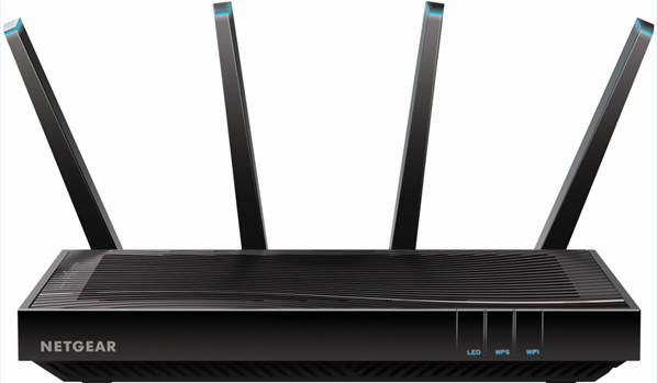

Front View
image of the front of the Netgear C7500
Click to enlarge.
After the cable modem successfully registers on the network, the Power, Upstream, Downstream, and Internet indicators illuminate continuously to indicate that the modem is online and fully operational. For more details, refer to the Troubleshooting section.

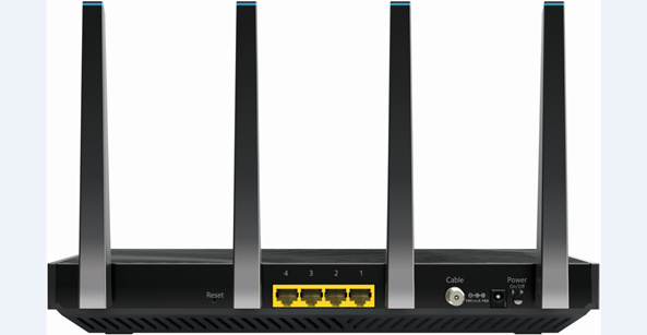

Back View
image of the back of the Netgear C7500
Click to enlarge.
The Netgear C7500 has the following ports available on the back of the modem.
  • Reset - Pressing the Reset button resets the modem. If the Reset button is pressed for
    at least seven seconds and the Power LED blinks white, the modem returns to its factory settings.
  • Ethernet - Four Gigabit Ethernet RJ-45 LAN ports to connect the modem to LAN devices. Only one port is active at a time.
  • Cable / coaxial - Connect the cable port to a cable wall outlet or a line splitter.
  • DC power connector - Connect the power adapter that came in the product package to the DC power
    connector.
  • Power - Press the Power On / Off button to provide power to the modem.

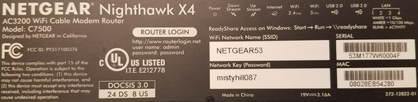

MAC Address
image of the Netgear C7500 MAC Address Label
Click to enlarge.
