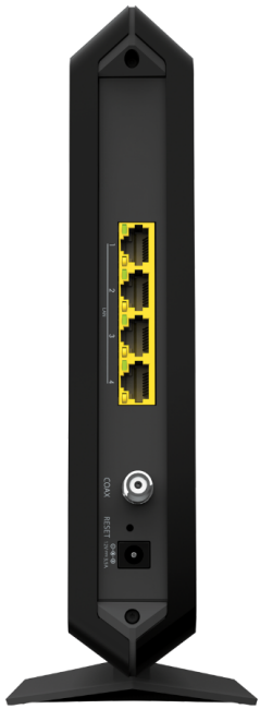

Back View
C7000 Back
Click to enlarge.
The Netgear C6900 has the following ports available on the back of the modem.
  • Ethernet LAN Ports - Provides internet access to a single device. Only one port is active at a time.
  • Coaxial Cable Connector (Cable / Internet - Connect your coaxial cable line to this port.)
  • Reset Button - Use this button in the unlikely event that you want to restore the default factory settings. This button is recessed to prevent accidental resets of your modem.
  • Power Adapter Input - Connect the supplied power cord to this port.
