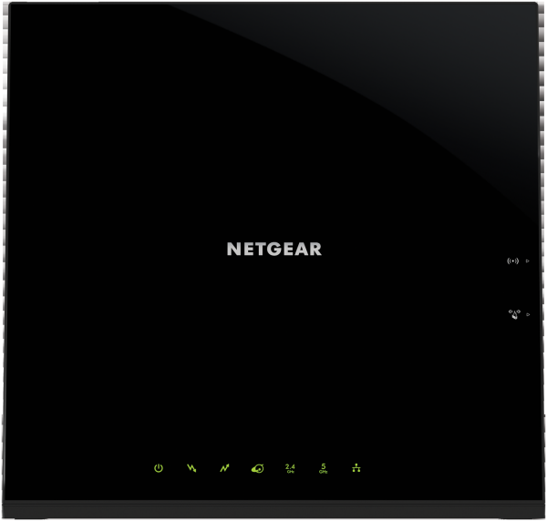

The Netgear C6250 is a DOCSIS 3.0 device offering 16 x 4 channel bonding and dual band WiFi connectivity.
After the cable modem is successfully registered on the network, the Power, Receive, Send, and Online indicators illuminate continuously to indicate that the cable modem is online and fully operational.

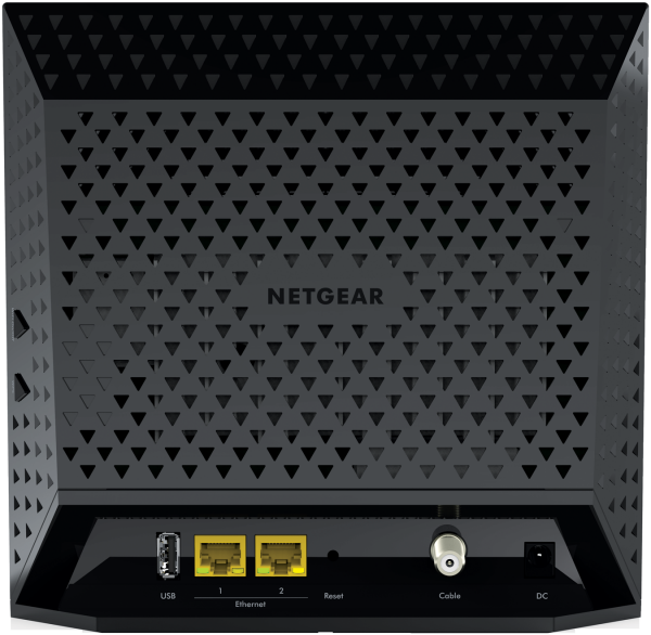

The Netgear C6250 has the following ports available on the back of the modem:
  • USB 2.0 - Connects to a USB hard drive, flash drive, or printer to the modem router.
  • Ethernet 1-2 - Two 10/100/1000 auto-sensing RJ-45 ports. Connect devices on your LAN (Local Area Network) such as a computer, hub, or switch to these ports. Only one port is active at a time.
  • RESET - Use this button in the unlikely event that you want to restore the default factory settings. This button is recessed to prevent accidental resets of your modem. See Netgear's support article for steps on how to reset your device to factory settings.
  • Coax - Connect your coaxial cable line to this port.
  • AC - Connect the supplied power cord to this port.

The modem lights indicate the current status of your WiFi cable modem. To troubleshoot any connection problems, use the table below.
Gateway LightStatusProblem
Power
image of the power
OffNo power - Verify all cable connections and try resetting the modem.
GreenNone
RedThe cable modem is too warm and might overheat:
  1. Disconnect the power adapter.
  2. Wait a couple of minutes to let the cable modem cool down.
  3. Make sure that the cable modem is placed in a vertical position.
  4. Make sure that the cable modem is placed in a location with good ventilation.
  5. Reconnect the power adapter.
Downstream
downstream
Blinking AmberScanning for downstream channel - Verify all cable connections and try resetting the modem.
Solid AmberNone - connection established on one channel
Blinking GreenScanning for additional downstream channels
Solid GreenNone - operating on more than one channel
OffDownstream channel inactive - Verify all cable connections and try resetting the modem.
Upstream
image of the upstream
OffUpstream channel inactive - Verify all cable connections and try resetting the modem.
Blinking AmberScanning for upstream channel - Verify all cable connections and try resetting the modem.
Blinking GreenScanning for additional upstream channels
Internet
image of internet
OffModem offline - Verify all cable connections and try resetting the modem.
Blinking GreenNone - scanning for configuration parameters - Verify all cable connections and try resetting the modem.
Solid GreenNone - operational
2.4 GHz
image of 2.4 GHz
Off2.4 GHz radio off.
Solid GreenNone - 2.4 GHz radio on.
5 GHz
ima ge of 5 GHz
Off5 GHz radio off.
Solid GreenNone - 5 GHz radio on.
Ethernet
image of ethernet
OffA device is not connected to the Ethernet port on the back. - Connect a device to the Ethernet port on the back.
Blinking GreenNone - An Ethernet port is transmitting or receiving data.
Solid GreenNone - A device is connected to the Ethernet port.
WiFi On/Off Button
image of wifi button
OffWiFi disabled.
OnNone - WiFi enabled.
WPS Button
image of WPS
Blinking AmberNone - This button lets you use WPS to join the WiFi network without typing the WiFi password.
The WiFi LEDs blink during this process and then light solid.
