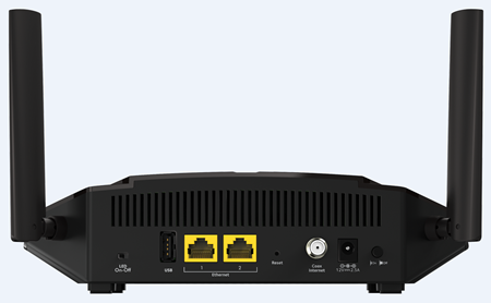

Ethernet
 | Off | A device is not connected to the Ethernet port on the back. |
Solid Green | None - A device is connected to the Ethernet port on the back. |
Blinking | The Ethernet port is sending or receiving traffic. |
USB
 | Off | Connect a device to the USB port to back of the device. |
Solid Green | None - A device is connected to the USB port on the back. |
