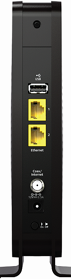

Back View
Back View of Netgear C3700v2
Click to enlarge.
The Netgear C3700v2 has the following ports available on the back of the modem.
  • USB - Connects to selected client devices.
  • ETHERNET - Two ports connect to the Ethernet port on your computer or home network.
  • CABLE - Connects to the cable wall outlet.
  • POWER - Connects the device to the power adapter.
  • POWER ON / OFF - Turns the device on and off.
    Note: The reset button is on the bottom of this modem.
