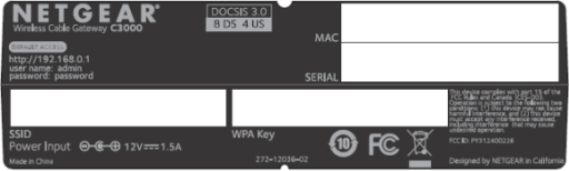

MAC Address
MAC sticker
Click to enlarge.
The Netgear C3000 comes configured with wireless security. By default, the Netgear home networking gateway supports up to 802.11n wireless standards and uses WPA / WPA2 wireless security settings.
  • The SSID and Passphrase are printed on the label on the gateway.
  • The SSID on the gateway is the same as the last 6 characters of the Wireless MAC address.
  • The Passphrase is the same as the 9-digit serial number of the home networking gateway.
  • MAC addresses are written as 12 digits containing both letters and numbers (0-9, A-F). A MAC address is unique. The first six characters of the MAC address are unique to the manufacturer of the device.
