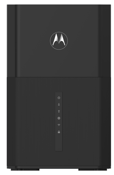

The modem lights indicate the current status of your cable modem. To troubleshoot any connection problems, use the table below.
Modem Light | Status | Problem |
Power | On | None. The modem is powered on. |
Off | No power. Verify power supply connections and electrical outlet. Ensure the outlet is not connected to a switch. Make sure the power adapter is securely connected in the power jack on the back of the modem. |
Downstream | Solid Blue | None. Multiple downstream channels are in use. |
Blinking Blue | Negotiating multiple downstream bonded channels. Verify all cable connections and try resetting the modem. |
Solid Green | None. One downstream channel is in use. |
Blinking Green | Scanning for downstream channels. Verify all cable connections and try resetting the modem. |
Upstream | Solid Blue | None. Multiple upstream channel is in use. |
Blinking Blue | Negotiating multiple upstream bonded channels. Verify all cable connections and try resetting the modem. |
Solid Green | None. One upstream channel is in use. |
Blinking Green | Scanning for an upstream channel. Verify all cable connections and try resetting the modem. |
Off | No upstream channels are in use. Verify all cable connections and try resetting the modem. |
Online | Solid Green | None. The modem is online with DOCSIS 3.0. |
Solid Blue | None. The modem is online with DOCSIS 3.1. |
Blinking Green | None. The modem is registering a connection. |
Off | The modem is offline. Verify all cable connections and try resetting the modem. |
WLAN | Off | WiFi is not enabled. If using WiFi, connect via WiFi using the SSID and passwrd on the bottom of the modem. |
Blinking | None. Data is being transferred over the WiFi connection. |
On | None. WiFi is enabled. |
WPS | Solid Green | None. WPS is in discovery mode. |
Off | None. WPS configuration is successful. |
