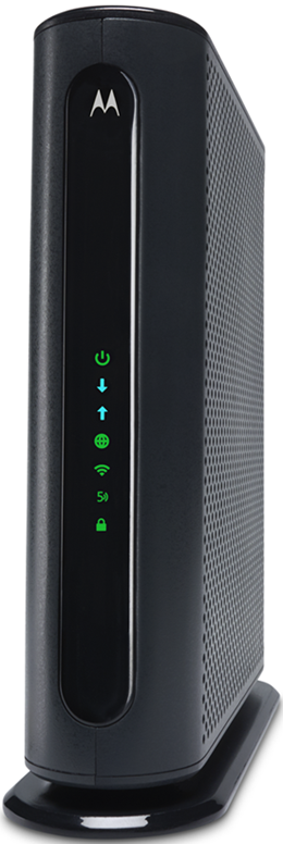

Front View
image of the Front View
Click to enlarge.
After the cable modem is successfully registered on the network, the Power, Downstream, Upstream, and Online indicators illuminate continuously to indicate that the cable modem is online and fully operational.

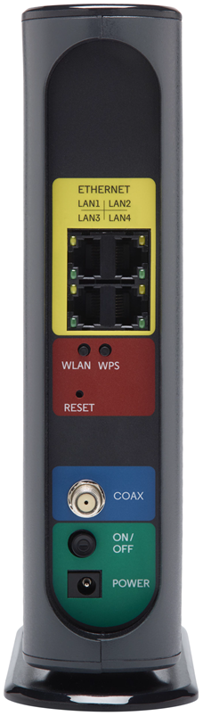

Back View
image of the Back View
Click to enlarge.
The Motorola MG7550 has the following ports and buttons available on the back of the modem.
  • ETHERNET LAN 1 2 3 4 - Provides internet access to a single device. Only one port is active at a time.
  • WLAN - Turns WiFi connectivity on and off
  • WPS - Press to turn on discovery mode
  • RESET - Press and hold this recessed button at least 10 seconds to restore to factory defaults and reboot the modem
  • COAX - Connects to a coaxial cable
  • ON / OFF - Turns the modem on and off
  • POWER - Connects to the power adapter
