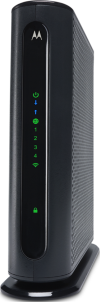

Front View
front view Motorola MG7310
Click to enlarge.
After the cable modem successfully registers on the network, the Power, Upstream, Downstream, and Internet indicators illuminate continuously to indicate that the modem is online and fully operational. For more details, refer to the Modem Lights section.

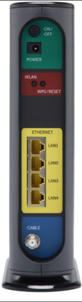

Back View
Click to enlarge.
The Motorola MG7310 has the following ports available on the back of the modem.
  • ON / OFF - Turns the modem on and off.
  • POWER - Connects to the power adapter.
  • WLAN - Turns WiFi connectivity on and off.
  • WPS / RESET - Press and hold this recessed button for at least 10 seconds to restore to factory defaults and reboot the modem.
  • LAN 1 2 3 4 - Connects devices to the 10 /100 / 1000 Ethernet port. Provides internet access to a single device. Only one port is active at a time.
  • CABLE - Connects to a coaxial cable.

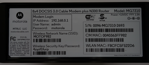

MAC Address
Click to enlarge.
  • The S/N is the serial number.
  • The CM MAC is the MAC address.
Troubleshooting
Modem Light Status Problem
Power
Power light
On None. The modem is powered on.
Off No power.
Downstream
Downstream light
Solid Blue None. Multiple downstream channels are in use.
Blinking Blue None. Negotiating multiple downstream bonded channels.
Solid Green None. One downstream channel is in use.
Blinking Green None. Scanning for downstream channels.
Upstream
Upstream light
Solid Blue None. Multiple upstream channel is in use.
Blinking Blue None. Negotiating multiple upstream bonded channels.
Solid Green None. One upstream channel is in use.
Blinking Green None. Scanning for an upstream channel.
Off No upstream channels are in use.
Online
Online light
On None. The modem is online.
Blinking None. The modem is registering a connection.
Off The modem is offline.
Ethernet LAN
Ethernet light
Green None. A device is connected to the Ethernet port and is using 1 Gbps LAN speed.
Amber None. A device is connected to the Ethernet port and is using 10 or 100 Mbps LAN speed.
Blinking None. Data is being transferred over the Ethernet connection.
Off No device is connected or the device is disabled.
WLAN
WLAN light
Off WiFi is not enabled.
Blinking None. Data is being transferred over the WiFi connection.
On None. WiFi is enabled.
WPS
WPS light
Blinking None. WPS is in discovery mode.
On None. WPS configuration is successful.
