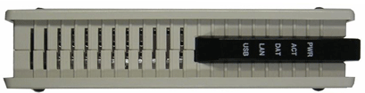

Front View
Front View
Click to enlarge.
The Joohong SL2810 is a DOCSIS 2.0 cable modem.
After the cable modem successfully registers on the network, the PWR, ACT, and USB or LAN indicators illuminate continuously to indicate that the cable modem is online and fully operational.
