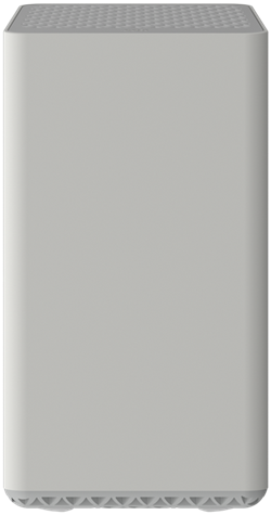

Front View
image of Front Modem View
Click to enlarge.
After the gateway is successfully registered on the network, a single solid white LED on the top of the gateway illuminates continuously to indicate that the gateway is online and fully operational.
