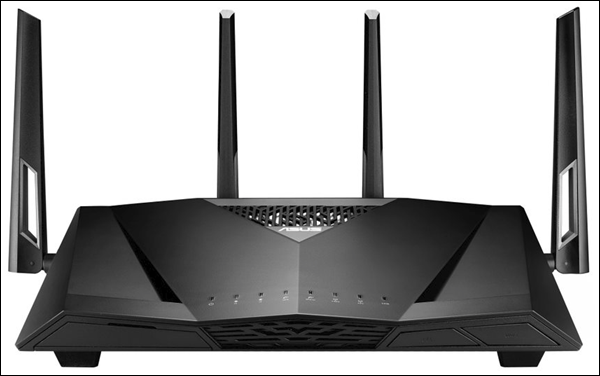

Front View
front view of the CM 32 modem
Click to enlarge.
After the cable modem is successfully registered on the network, the Power, Upstream, Downstream, and Online indicators illuminate continuously to indicate that the cable modem is online and fully operational. For more details, refer to the Modem Lights section.

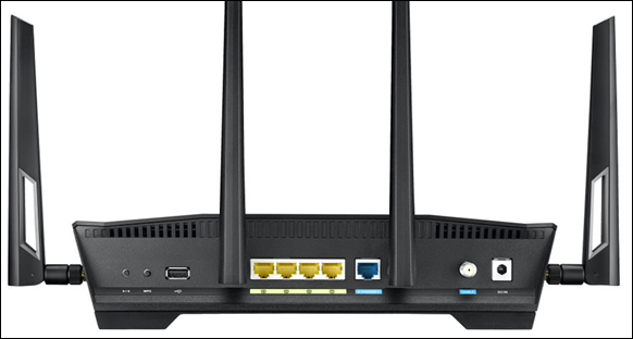

Back View
back of asus CM32 modem
Click to enlarge.
The Asus CM32 has the following ports available on the back of the modem.
  • RESET - Use this button to reboot the modem or restore to factory defaults. It is recessed to prevent accidental resets.
  • ETHERNET - Connects to the 10/100/1000 Ethernet ports on your computer. Provides internet access to a single device. Only one port is active at a time.
  • CABLE - Connects to the cable wall outlet.
  • POWER - Connects the modem to the power cord.
