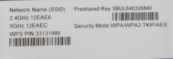

WiFi Network Label
Network name label
Click to enlarge.
 This label is located on the bottom of the device, which contains the default Network Name (SSID) and Passphrase (Preshared Key).
