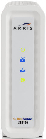

Front View
SB6190 Front
Click to enlarge.
After the cable modem successfully registers on the network, the POWER, RECEIVE, SEND, and ONLINE indicators continuously indicate that the cable modem is online and fully operational.

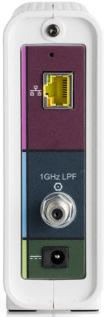

Back View
SB6190 Back
Click to enlarge.
The ARRIS SB6190 has the following ports available on the back of the modem.
  • RESET - Reboot the cable modem or reset the cable modem settings.
    Press the indented Reset button once using the end of a paper clip or other small object with a narrow tip, and then release. To reset back to the factory default settings, press and hold the indented Reset button for 15 seconds using the end of a paper clip or other small object with a narrow tip, then release.
  • ETHERNET - Connects to the Ethernet port on your computer
  • CABLE - Connects to the cable wall outlet
  • POWER - Connects the cable modem to the power adapter

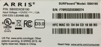

MAC Address
SB6190 MAC Label
Click to enlarge.
MAC addresses are written as 12 digits containing both letters and numbers (0-9, A-F). A MAC address is unique. The first six characters of the MAC address are unique to the device's manufacturer.
Troubleshooting
Modem Light Status Problem
POWER
power light
Off No power. Verify all cable connections and try resetting the modem.
Solid Green None.
RECEIVE
Receiving
Flashing Scanning for a downstream channel. Verify all cable connections and try resetting the modem.
Solid Green None. Connection from the computer to the Internet is established on one channel.
Solid Blue None. Operating on more than one channel (downstream bond mode).
SEND
Send
Off The upstream channel is inactive. Verify all cable connections and try resetting the modem.
Flashing Scanning for the upstream channel. Verify all cable connections and try resetting the modem.
Solid Green None. Connection from the Internet to the computer established on one channel.
Solid Blue None. Operating on more than one channel (upstream bond mode).
ONLINE
online
Off No connection. Verify all cable connections and try resetting the modem.
Flashing None. Scanning for configuration parameters.
Solid Green None. Operational.
