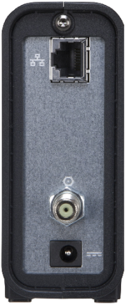

Back View
Back View of SB6182
Click to enlarge.
The ARRIS / Surfboard SB6182 has the following ports available on the back of the modem:
  • ETHERNET - Connects to the Ethernet port on your computer
  • CABLE - Connects to the cable wall outlet
  • POWER - Connects the cable modem to the power adapter
