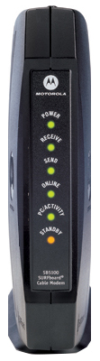

Front View
Front View of SB5120 modem
Click to enlarge.
After the cable modem is successfully registered on the network, the POWER, RECEIVE, SEND, and ONLINE lights are on and the PC/ACTIVITY light flashes when the cable modem is transferring data.

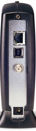

Back View
Back View of SB5120 modem
Click to enlarge.
The Arris / Motorola SB5120 has the following ports available on the back of the modem.
  • POWER - Connects the cable modem to the power adapter.
  • CABLE - Connects to the cable wall outlet.
  • USB - Connects to the USB port on your computer.
  • ETHERNET - Connects to the Ethernet port on your computer.

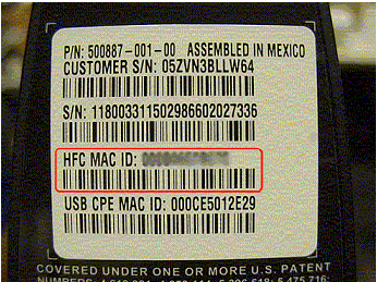

MAC Address
MAC Address for SB5120 modem
Click to enlarge.
Troubleshooting
Modem LightStatusProblem
POWEROffNo power. Verify power supply connections, the power switch on the modem itself, the electrical outlet, and make sure the outlet is not connected to a switch.
FlashingError has occurred during normal operation. Verify coaxial cable connection and try resetting the modem.
RECEIVEFlashingScanning for a receive (downstream) channel connection. Verify all cable connections and try resetting the modem.
OffNo downstream connection. Verify all cable connections and try resetting the modem.
SENDFlashingScanning for a send (upstream) channel connection. Verify all cable connections and try resetting the modem.
ONLINEFlashingScanning for the network connection. Verify all cable connections and try resetting the modem.
PC/ACTIVITYFlashingNone. Transmitting or receiving data.
STANDBYOnStandby button pressed, Internet service blocked, all other lights are off. Press the Standby button.
