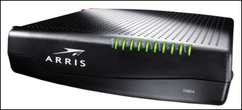

Modem Status Indicator Lights
All of the Internet and Voice modems Cox uses for telephone service have at least eight status indicator lights. The number of lights depends on the number of telephone lines the modem can support and how many are installed. The status indicator lights are clearly marked. Usually, the Battery status indicator light will be located on the left-hand side of the status indicator light field. On some models, the Battery and Power status indicator lights are reversed.
Battery indicates the status of the battery in the modem and Power indicates whether AC power is available to the unit. Both of these status indicator lights should produce a steady green light.
See the table below for statuses indicated by the battery and power lights.
Modem Model | Power Light | Battery Light | Status |
Arris models:
| Solid | Solid Green | No problem |
Flashing Green | Action Required | ||
Off | Missing |
For Arris models 508 and 512, contact Cox Communications.
Potential Corrective Actions
Here are a few troubleshooting steps you can try on your own.
- If the Power Light is off or flashing, check the power source to ensure the device is plugged into a wall outlet or power strip. If it is plugged into a power strip, ensure the switch is on.
- Ensure the power cord is tightly connected to the device.
- If the device is connected to a power strip, bypass the power strip and plug the device directly into a wall outlet.
If the above actions do not result in the status lights displaying a solid green light, contact us immediately.

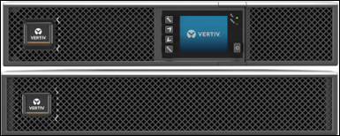

Customer Premise Equipment Status Indicator Lights
Cox Business deploys other Customer Premise Equipment (CPE) to support critical voice lines delivered over Cox’s network. This equipment includes Adtran IADs and a Vertiv UPS device, which usually include 8-hour battery backup options. The included equipment is as follows.
- Vertiv UPS GTX5-500LVRT2UXL UPS
- Vertiv GXT5-EBC36VRT2U External Battery Cabinet
- Vertiv RDU101 network management card
See the table below for Vertiv UPS unit indicator light details.
Device Model | Power Light | Battery Light | Status |
Vertiv UPS + Battery | Solid | Solid Green | No problem |
Solid Amber | Battery backup active | ||
Off | No power |
