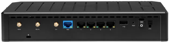

Modem / LTE Backup RouterEmbedded C4D
Ethernet5 X GbE RJ45
WiFiDual-radio, dual-band, concurrent operation (2.4 and 5 GHz)
Note: The WiFi radios are disabled.
Expansion/Console1 X USB 2.0 Type A
GNSS/GPS1 X SMA GNSS antenna connector
PowerExternal DC power supply, 100-240 VAC input, 12 VDC 2A output

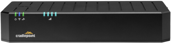

LED Indicators
The lights indicate the current state of your LTE backup.
IndicatorStatus
Power
image of the power icon below led indicator
  • No Light: Not receiving power
  • Green: Powered on
  • Blinking Green: Powered by battery
  • Yellow: Attention
  • Blinking Yellow: Battery needs replaced
    Note: The E100 does not use a battery.
Signal Strength
image of the signal icon below led indicator
  • No Lights: No signal
  • 4 Solid Bars: Strongest signal
  • 1 Blinking Bar: Weakest signal
  • 4 Blinking Bars: Battery door is not installed, LTE backup is off
Embedded Modem / LTE Backup Router
image of the lte router icon below led indicator
  • No Light: No removable LTE backup detected
  • Solid Green: LTE backup is providing internet service
  • Blinking Green: LTE backup is connecting
  • Blinking Yellow: Data connection error
  • Solid Yellow: LTE backup in standby; no issue detected
  • Blinking Red: LTE backup is in the process of resetting
WiFi
image of the wifi icon below the led indicator
  • No Light: WiFi is not operating
  • Blue: WiFi is on and operating normally
    Note: WiFi is disabled.
