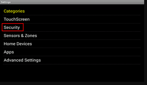

From the Touchscreen Settings menu, tap Security.
Image of Settings Menu

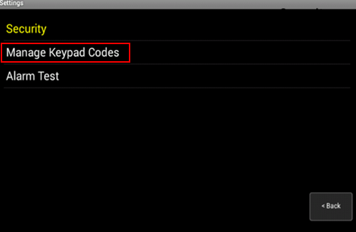

From the touchscreen Security menu, tap Manage Keypad Codes.
Image of Manage Keypad Codes

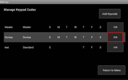

On the Manage Keypad Codes screen, tap Edit in the Duress field.
Note: The duress code cannot be deleted, only edited.
If the duress code is enabled, tap 4-Digit code field to change your current code.
If the duress code is disabled, tap Enable Duress Code.
Enter the new 4-digit duress code.
Note: Verify the new code before you save it.
To activate your new duress code, tap Save.
