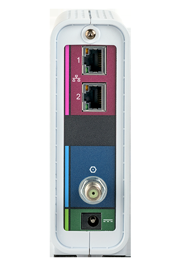

Back View
Click to enlarge.
The following ports are available on the back of the modem.
  • Ethernet - Two Ethernet ports for RJ-45 network cable connections.
    • Green LED indicates a GigE data connection is made.
    • Amber LED indicates a 10/100 Mbps data connection is made.
      Only one gigabit Ethernet port can be used at a time. Therefore, a second device plugged into the modem will not receive Internet access.
  • Reset - Recessed button located on the back of your SB8200 can be used to either
    reboot the cable modem or reset the cable modem configuration settings.
  • Cable / Internet - Connect your coaxial cable line to this port.
  • Power - Connect the supplied power cord to this port.
